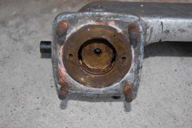

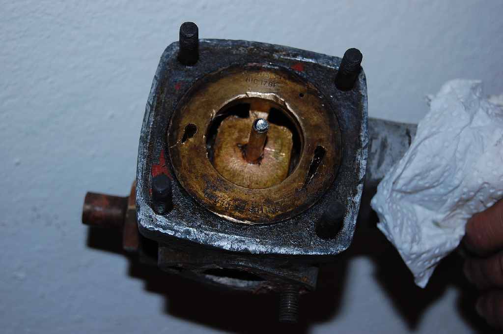

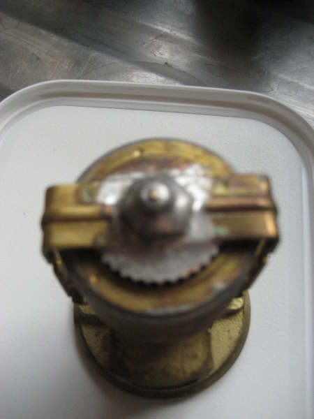

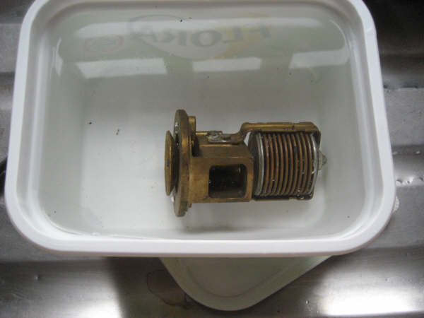

    I was trying to check the thermostat sitting in the elbow above the cylinder head. I do not understand how it should work, I think something is missing (broken away).
    When I heat it in the kitchen, the pin in the middle closes the little hole in the middle of the brass part but all the openings around let always water through, so there is no difference in flow then.
    It looks very difficult to remove the brass part, looks like somebody tried it and did not succeed (creating two holes right and left in the brass part, probably by hammering on a screwdriver).

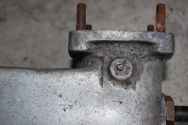

    In the other image you see a little brass pin which looks like a snapped off screw, what is it for ?
    So my questions: how does it work, how can it be removed, and is there replacement available or what is mising ? (or do I misunderstand the function)

    Hi Peter, The broken brass bit! It is a small brass screw which seems to be a blanking screw and serves no purpose? I could be for some sort of temperature gage possibly in the Aston Martin DB2-4. The thermostat I will leave to those better qualified.
    Peter

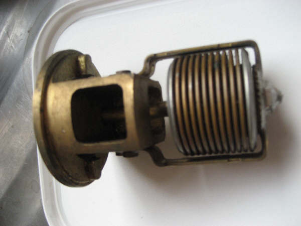

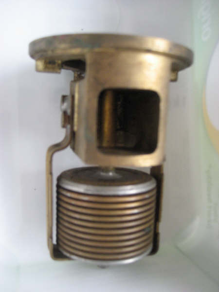

    Some helpfull images I received from John showing the thermostat taken out from the aluminium elbow

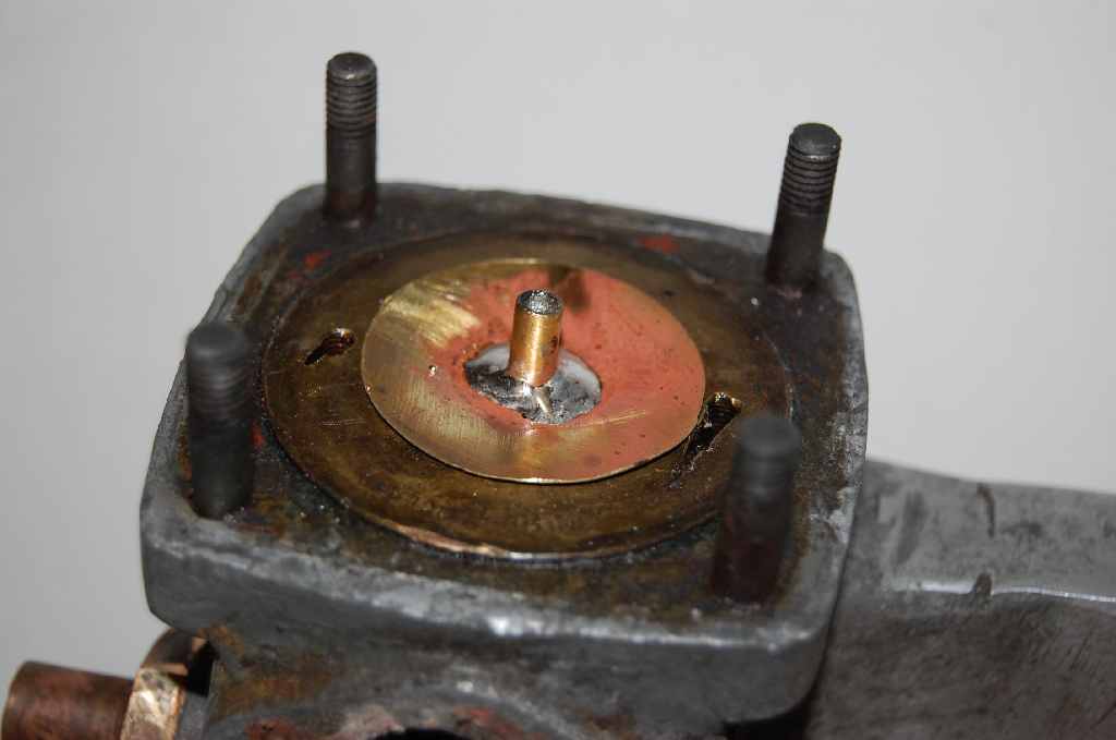

    16 June 2008 at 07:22 #47373

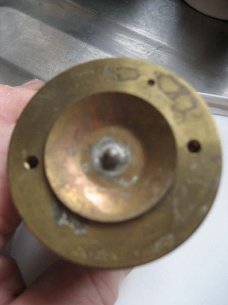

    I was not able to get the brass part out of the aluminium elbow and did not want to destroy anything.
    Thanks to the helpful photos I reconstructed it “in situ”. I heated it with a hair-dryer until the remaining part of the pin moved out, then soldered a short tube on it and finally a saucer shaped brass disc. It is now at a position that it starts to open at 45Celsius and is fully open at 60Celsius
    20 June 2008 at 08:02 #47382
    Congratulations Peter! I am delighted to see this clever and innovative aproach to an in situ repair.
