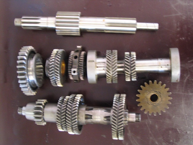

    Julian Messent
    7 July 2011 at 11:52 #48348
    Afternoon Bill,
    We do indeed stock G9 box sets also,
    This is the full monty with everything included including synchro hubs and bronze linings, but does not include the round cage that goes over the main synchro hub. This never wares and only holds the balls in place, so would be silly to manufacture, the centre part of the main hub with the fine dog ring teeth on it though is included and this is matched to the new synchro hubs on 3rd and 4th.
    The attachment shows the kit but you also get the reverse shaft and bronze syncro friction rings etc.
    Price is I am afraid 8850 euros as it is rather more complex box and the usual problem is dog ring teeth wearing tapered meaning there is no getting away from the expensive parts for us :o(
    Hope this helps but actually hoping you won’t need them!!
