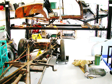

    The attachments show where I am at now, with mine.
    Ken Douch Sooke British Columbia

    ken douch
    14 April 2012 at 22:22 #48927
    Hi Tony
    Having had a close look at the MK2, restoration is not too difficult as compared to a rusty XK for instance.
    The body can neatly be separated from the chassis and, although it is a composite construction of an aluminium shell on a steel and wood frame, it is very repairable provided it has retained its structural integrity.Except for the ash frame certainly no worse than a comparable American sedan.
    The chassis is a little more complex than a live axle car, but having been built to tractor standards it is emminently rebuildable with few unique parts needing renewal.
    Most system parts,Lucas, Lockheed,SU etc. are used on other contemporary makes such as Jaguar and Rover and are available as secondhand or reproduction.
    The Achilles heel appears to be the engine and gearbox which are more suited to a lighter sportscar,but I am avoiding this.The “professional”(Farmer?) engine swap will be done properly(although reconvertable) by this amateur.
    So my put is that, if it is in one piece, the DB3l is worth saving even if it does look sad.
    The skill is not to spend too much more on it, than it is worth when finished, as this is in the eye of the beholder!
    Ken
    SRD
    15 April 2012 at 07:15 #48929
    Ken good morning,
    May I assume from your posts that you are changing the engine and gear-box or does your car come without its original engine and box ?
    Your pictures show what appear to be two different cars or is this just a reflection of some elbow grease on the paint-work!!
    Kind regards and more pictures of your work and how you found the car and resoration porgress would be greatly appreciated.

    ken douch
    15 April 2012 at 22:06 #48932
    Here is one just seen at the OECC restoration Fair today
    http://www.porters-garage.com/L1.htm
    Ken
    ken douch
    16 April 2012 at 17:07 #48933
    Hi Simon
    Yes that is a 4.2 Jaguar engine (you can tell by the fact that the carburettors are on the more usual side)
    The lower picture is from when the car was on sale in Ontario.
    Now waiting for the T5 gearbox from Massachusetts (TVR spec) to see how far forward the engine has to be.
    More details as the plot unfolds
    Ken
