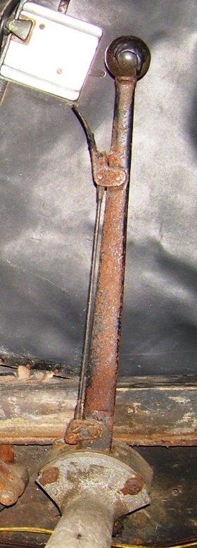

    Alec Rivers-Bowerman
    21 August 2014 at 06:07 #50965
    Finished up redoing my gear lever – very happy with the results. I made the new reverse lever & pawl, rod, rod ends and screws out of stainless (the old ones were too pitted to easily salvage).
    Alec
    Barry Brown
    21 August 2014 at 23:46 #50967
    Nice work Alec. It looks great !
