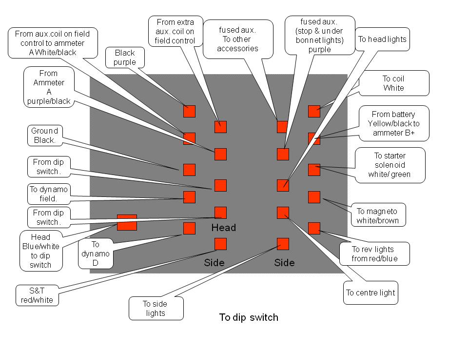

    The Autosparks lomm for the M45 is not exactly correct but good enough and if you are restoring an M45 you might like to use the attached dagram of the underside of the control box. I found this very useful.

    I hope the diagrams helps.

    With reference to your layout of the M45 Control Box please be aware that this is only one version so it is very specific.

    I did the diagram for my own use when I wired my M45, and was very aware that different configurations and versions of accessories were used on the same model. That’s why I did it.
