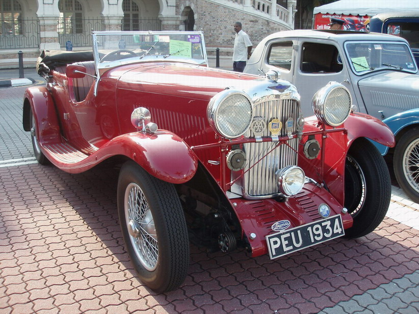

    My 16/80 is used at least once a week and is giving marvellous service, covering at least 3000 miles since the rebuild. The only hiccup was a blocked inline fuel filter which showed the wisdom of fitting it because the original mesh filter which is still in place up-line picked up nothing! A more recent photo is attached.
