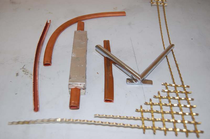

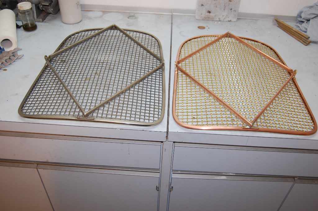

    Like many details of the 2ltr cars I like the diamond symbol pressed into the leather of the passengers door which also is found in the (optional) stoneguard, which on mine was missing. It was a tempting job to build one, as close to the original as I could. A friend with another 2ltr living nearby gave me his as template. I used ordinary 1/2″ copper tubing and pressed the drop shaped profile for the diamond in special vice jaws milled out of aluminum. The outer profile is U-shaped and I first have bent the tubing under heat, then pressed the copper tube flat and then cut it open with a band saw. The diamaond was soft soldered (it is not flat see photo!). The distance cross-bar to radiator on my car seems larger than on the car of my friend so I introduced a little intermediate plate in the mounting. All parts were chromed and I think the result is quite nice.

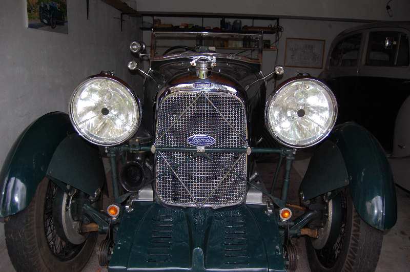

    chromed an mounted:
    SRD

    Peter hi
    A beautiful job, looks great on your car.
    All the best
    Simon
    This reply has been reported for inappropriate content.
    David Bracey
    1 January 2016 at 16:55 #51657
    Peter, you must be proud of that. A really superb job – well done and thanks for posting.
