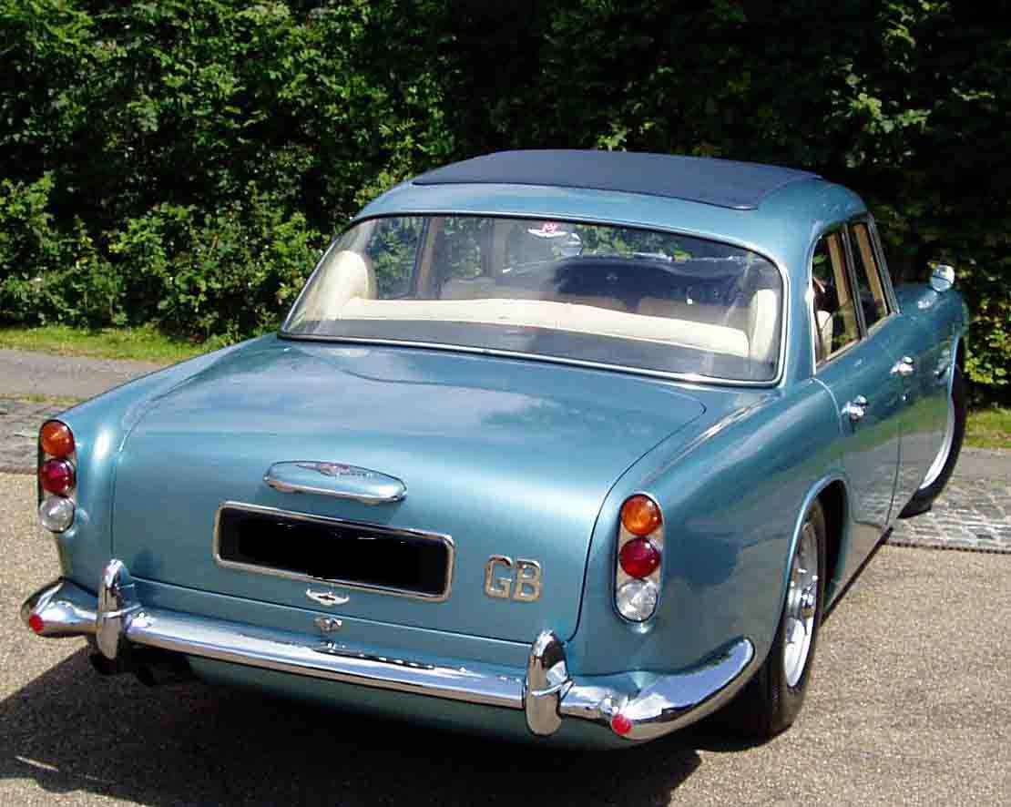

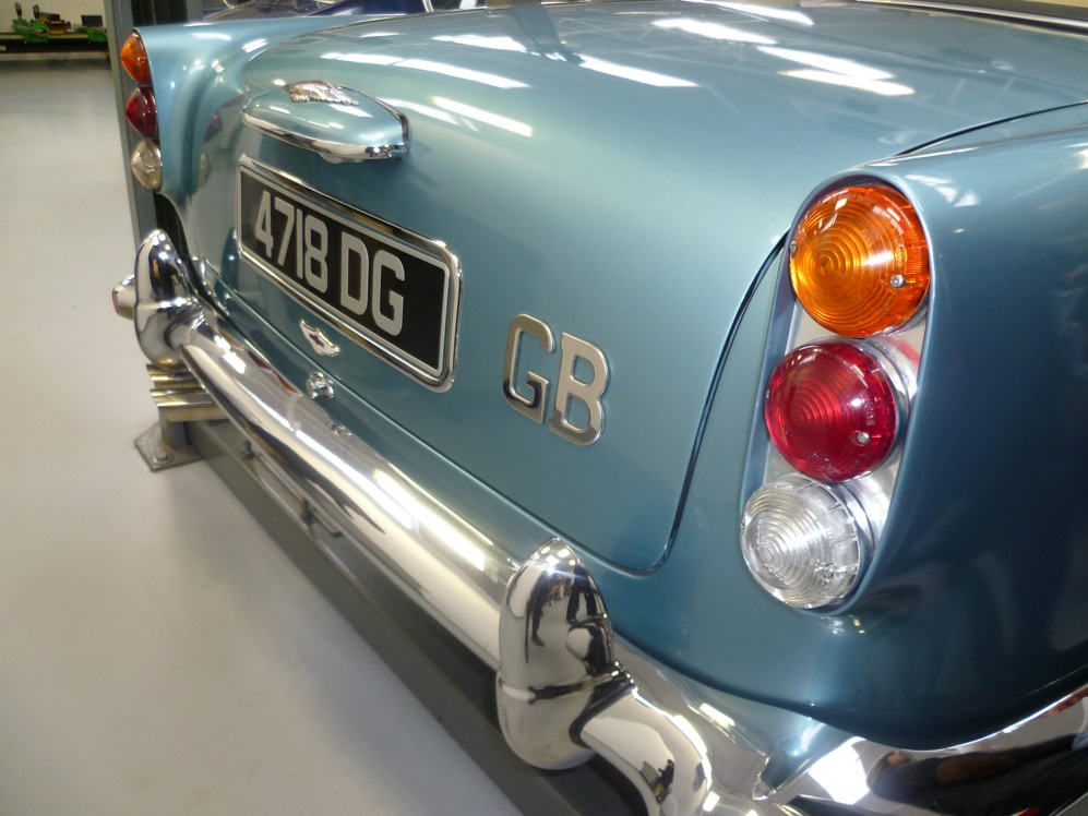

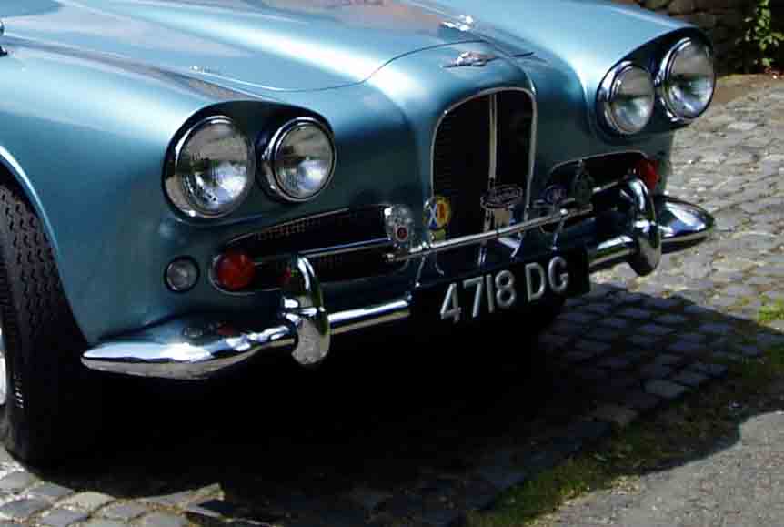

    Here are a few pictures of the car, with best close-up’s of the bumpers.
    The pictures of the rear of the car, shows the bumper in the central area, practically touching the body.
    I would suggest that while the profile and fitment of the bumper might be correct for 108, it would require a fair bit of fettling and/or shimming to fit another car, nothing is quite the same between any of these two cars.

    There’s a bit of flexibility in the bumpers but it would have to be done very carefully. My original bumpers, though rusty, were undamaged and the body below was the right profile (as in not damaged or pushed in). As you point out, no two cars are the same and certainly I’ve found more than a few areas which were factory adjusted to suit – definitely a hand made car!

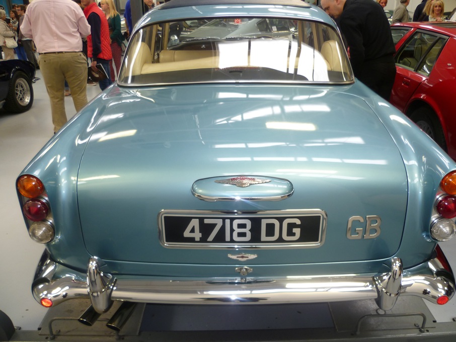

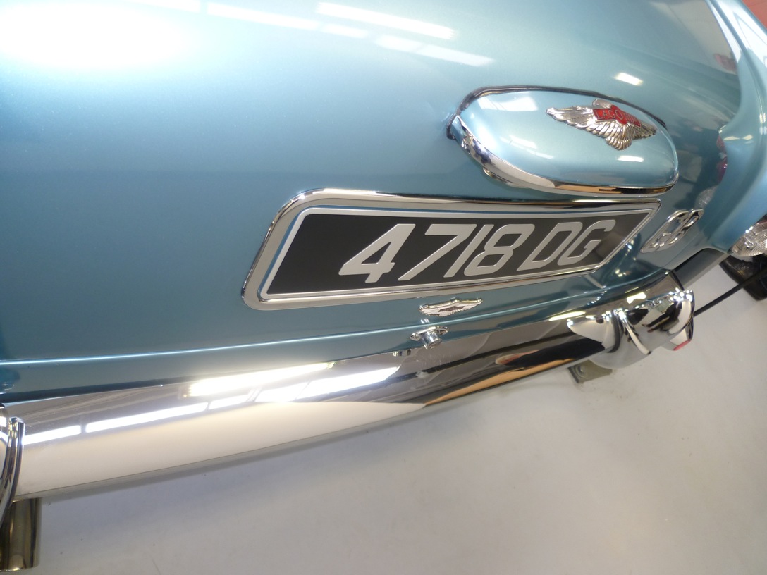

    Here are some snaps……

    It could be improved but it doesn’t seem to follow the line of the body that well – could be the body that’s at fault – valances are vulnerable to dings. Paintwork looks good, is it? There’s no rear window demister – is it a heated window or were demister vents not put on every Rapide? GB badge is not Ace…

    I don’t think the body is particularly at fault, just that the shims are about 1 cm too short

    Seeing Tim’s photos of the 3 litre reminds me that 129’s boot lid was misaligned and some 3-4 mm proud of the rear tonneau, straight on the car as Tim’s image above shows but too high at the leading edge

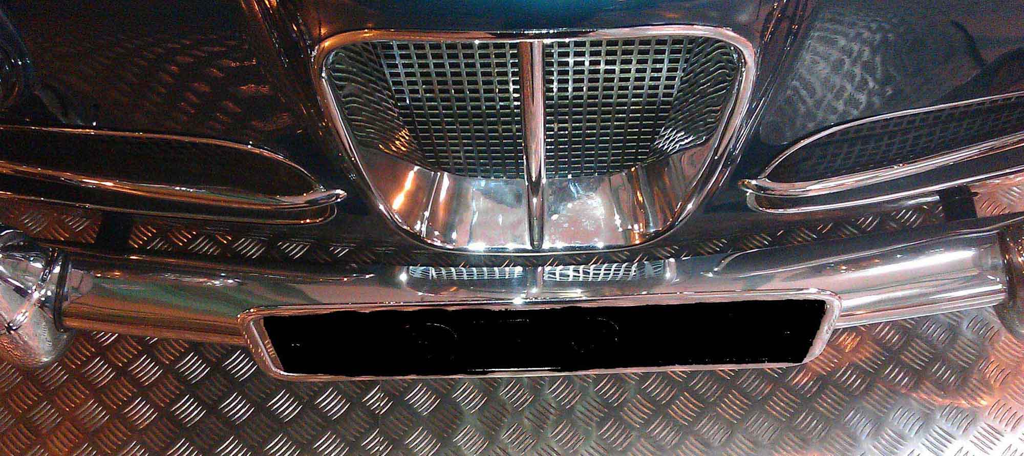

    A Rapide which lives local to me, with a more generous gap (ca. 2 cm) between the body and front bumper, using more extensive shims.
    I do agree with Christian, the bumper does not follow the line of the rear body.
